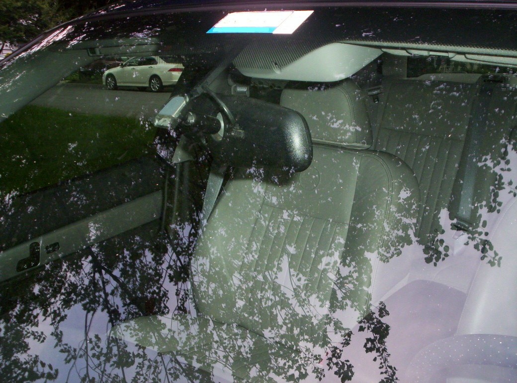

    Well, I guess a picture is worth 1000 words. I'm missing, well, EVERYTHING except the rear view mirror. I have no wire, and no long plastic wire cover. Now, in addition to a new windshield, my car has a new roof too (severe hail damage). I'm thinking the wire wasn't put back on the car by the body shop when they dropped the headliner. This doesn't make me happy. I suppose the mate to the wire from the mirror is under the headliner somewhere..?
