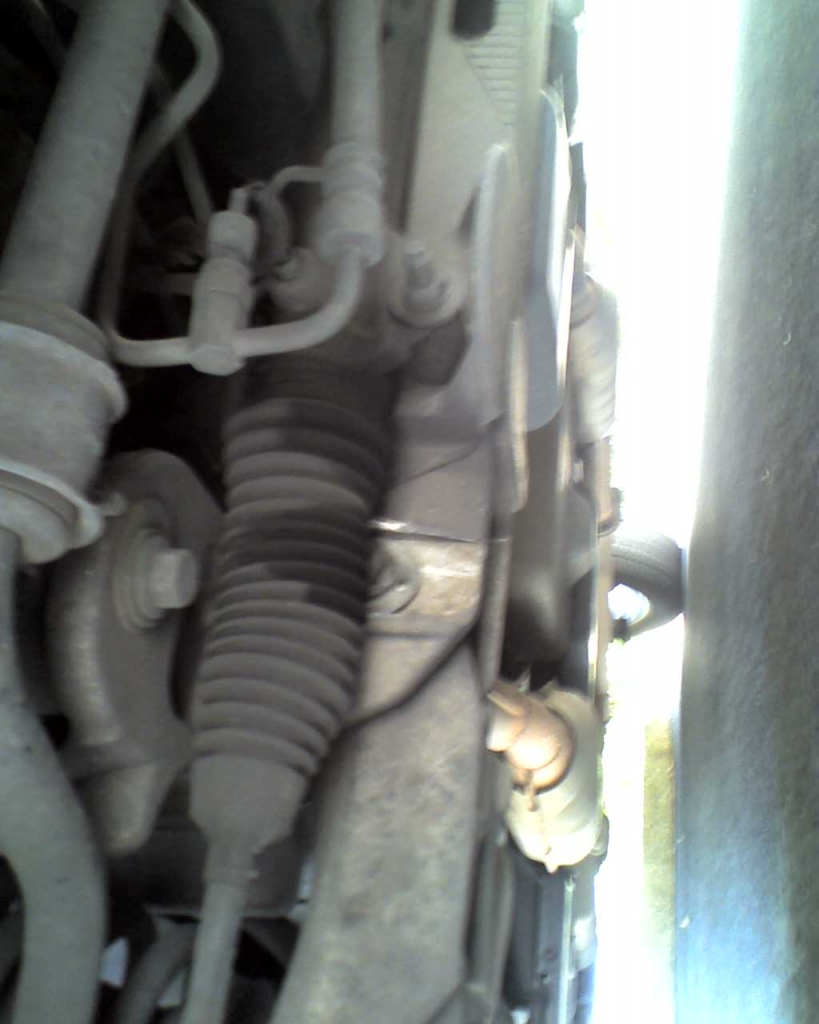

    They need to remove the Flag off of the Front of the bolt.

    Ok....sorry for the poor quality of the pic but I took it with my camera phone the bolt is the one behind the boot:

    I know what your saying, its just that I don't see it....slap an arrow on the picture pointing to the flag and I'll run out and look on my car....you think I should remove it before bringing it in? I'm thinking the guy will be hesitant to do so....

    THIS IT?

    on this pic where you put the arrows...that piece has already been removed....this pic shows what it should look like after being done properly, thats why its kind of shinier than whats around it.

    As far as removing it...thats what they are supposed to do when doing the alignment
    Does any body have a better picture of this? Certainly SID210SA isn't the only one who has had this done.
    I also got the NO GO comment from the alignment shop but set it as close as possible.

    Alignment guys are often not the brightest..... I found a dealer tech who lets me use their alignment rack at night myself so I know it's done right..... I can send you a pic of the flag tonight. I took pics when I took them off to align the car a little while ago

    Here is a picture of the "flag". If this is still on, they didn't set the camber.
    Current:
