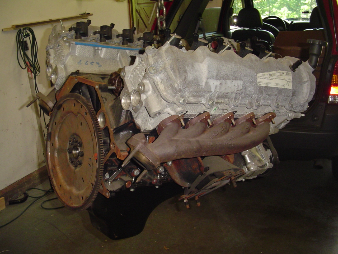

    This thing is HUGE
    Here it is:
    I love Modular engines, because they are, well, 'MODULAR'!
    I was concerned about the oil and water neck on the drivers side:
    Stock Water & Oil cooler pic:
    Pic with Marauder motor mount:
    Pic with Marauder Water Outlet:
    So far so good... er....Oil pan
    Stock vs Marauder:
    Stock Marauder pan bolted up:
    So, to get this thing in the car, Im going to order another Marauder Oil pan.
    Then I will lay the v10 pan out on cardboard and spray some paint through the holes, creating a template. Once I have that, I can cut the front section off the old Marauder pan and weld it onto the new Marauder pan to fit.
    As is, the V10 pan will hit the crossmember and is way too deep (9.5" vs 6.25 on the MM)
    A small adjustment to a stock MM oil pick up tube and the engine will be in the car.
    I must admit Im scared of the electrical wiring needed for this to be a success. I have the best brains working to see if the Marauder computer has the extra drivers built in to run 2 extra cylinders. If so this will be much easier than I thought.
    If not, I will have to adapt the V10 computer to run the engine and other essential MM functions, and most likely buy a stand alone Bauminator 4R70W transmission controller.
    Ill keep everyone in the loop
