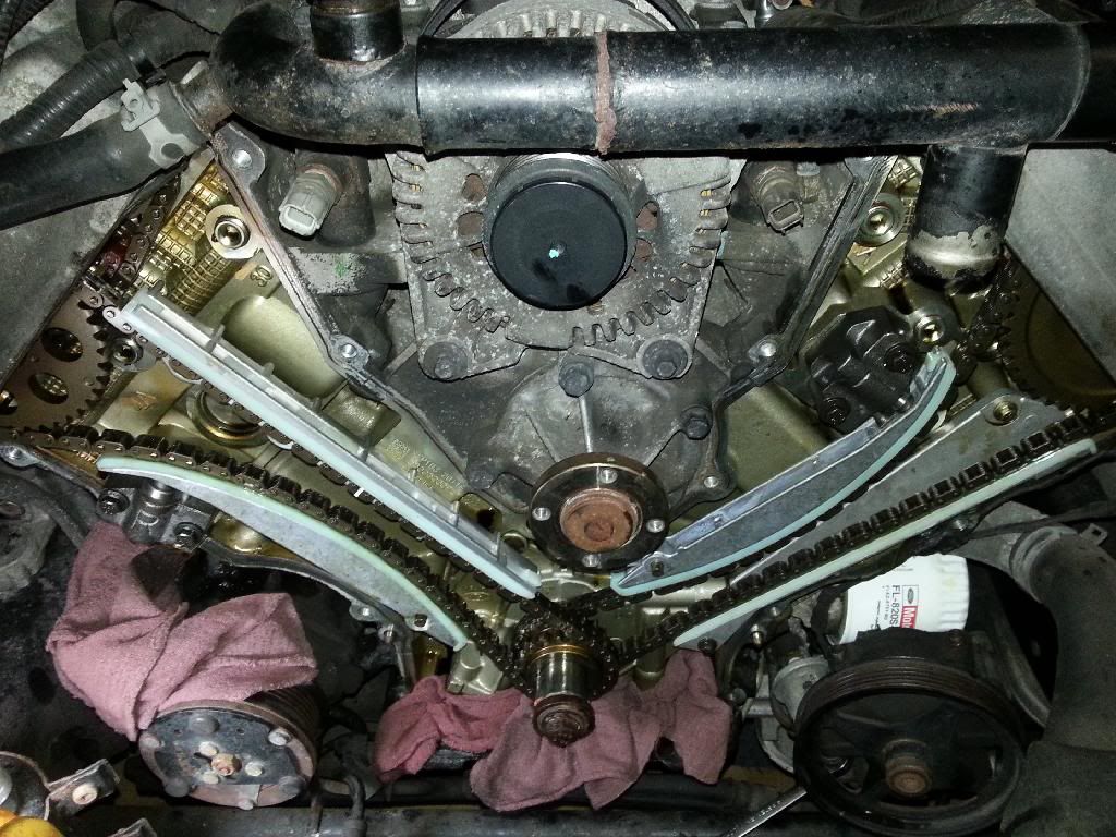

    Thread I started a couple years ago talking about the metal tensioners.
    http://www.mercurymarauder.net/forum...ad.php?t=92299
    Pictures from when I had mine replaced, new metal tensioners and guides.
    NOTICE the Passenger side guide has ZERO nylon material on it. The chain actually grooved the metal of the guide.

    How many miles are people seeing before these parts need replacing? I'm at 205K.
  15. #30
    Apr 2010
    South Florida
    35
    1,900
    Quote Originally Posted by ByronRACE View Post
    I changed mine at 117k, I started hearing start up noises around 105k. I believe they were all original parts inside.
