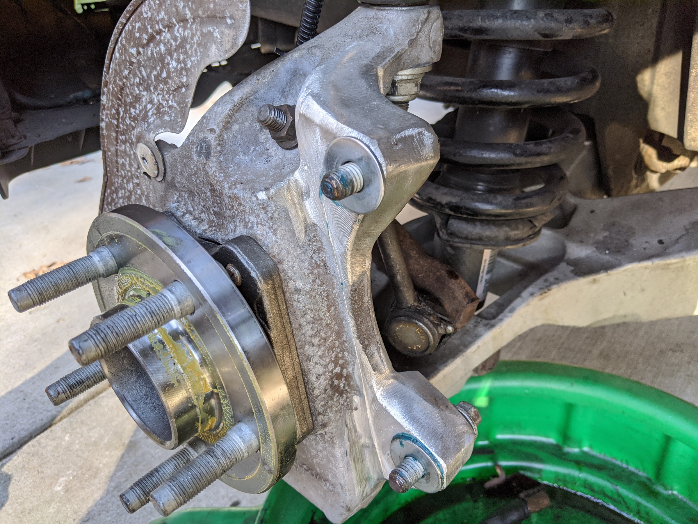

    Once the knuckles were welded, the caliper bosses needed to be trued to the hub boss. I indicated the hub boss to the mill and then made a caouple passes with a face mill to true the caliper bosses to the hub. I decided that it would be best to have the ability to shim the fixed caliper as needed so I took some extra material to match the thickness of some washers I had in the shop. You'll see the shims in pictures later.

    Here they are mocked up and ready to be assembled onto the car.

    Assembling the knuckles onto the car is no different than OEM. I used the hoses mentioned on the first post and they came with brackets that were easily modified so that mounted using the stock location. I will modify this later because the bracket holds the hose and not the fitting which leaves some room for the hard line to move just a little. In these pictures you can see the shims in place so that I can move the fixed caliper inboard or outboard as necessary.

    Here is the complete assembly. The caliper can probably be moved 1/16" toward the hub, but I will leave that for the mod1 version.

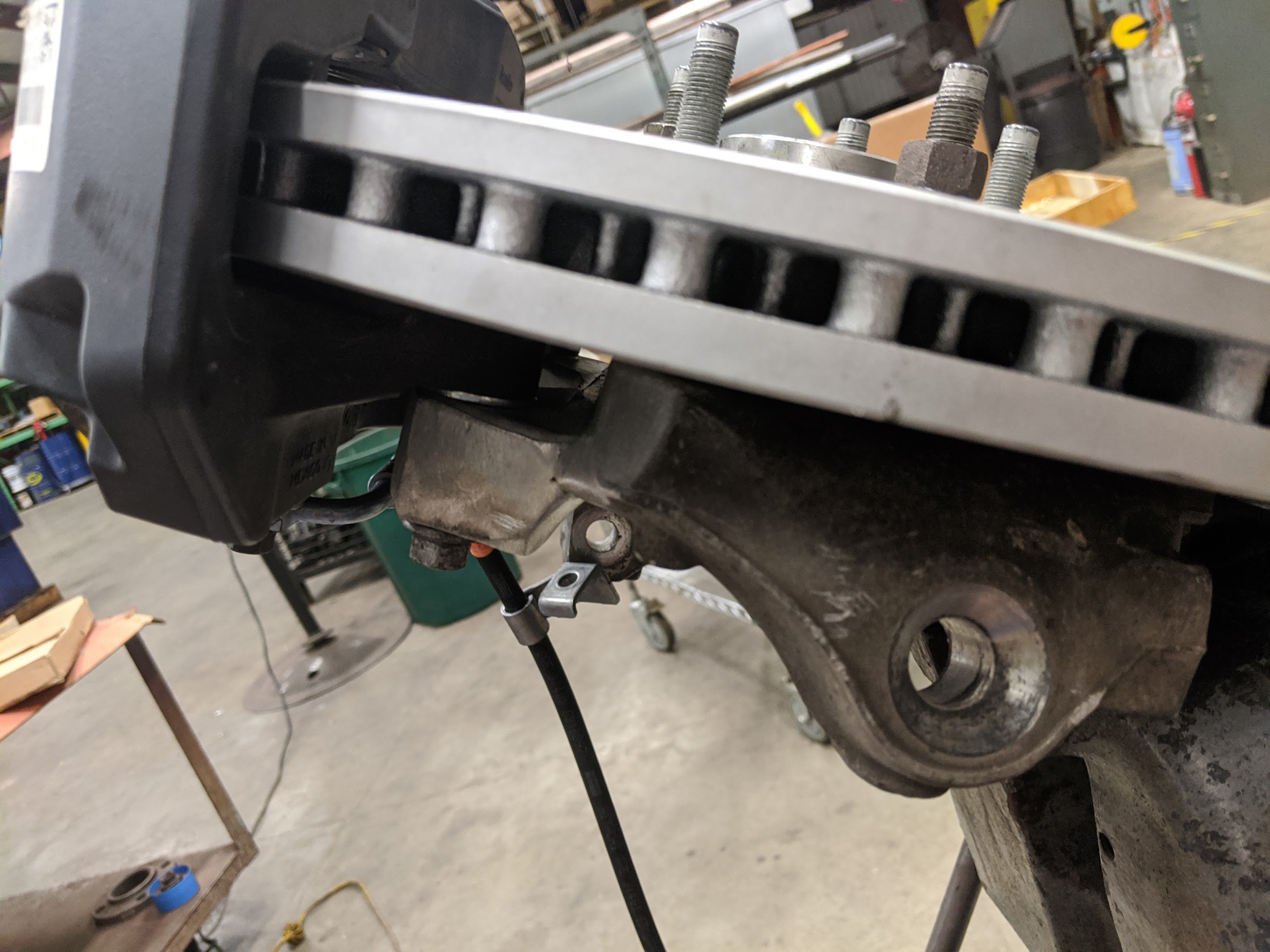

    Not a chance, but there is hope... Because this now uses mustang mounting locations you can use any mustang brake that fits the 05-14 cars. I wish I had the the Boss302 Brembos with 14" rotor to check but I don't have access to them. I suspect that they may fit under the stock wheel with a spacer. To that end, I didn't want to leave the car on the stands so I put on a set of new takeoff S197 aluminum floating calipers until I can get the wheels I want. One big note, the piston area is smaller on the mustang caliper so the pedal feels firmer, but it definitely shifts the brake bias a little and is something everyone should be aware of.

    So long story short I can now swap calipers, rotors, and wheels in about an hour or two and go from 2-piston floating 12", to 4-piston fixed 14", to 6-piston fixed 15" with a quick pressure bleed and change the wheels to match. Sorry I don't have a better picture, I'll grab one later, but this is the mustang 2-piston floating caliper on the same knuckle.
