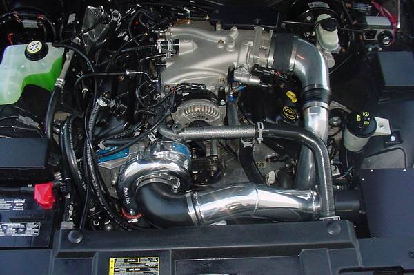

    Just like fine wine that grows with time, so does hard work and patience. I want to thank Kelley for being patient with me on his car. We have rebuilt the transmission, added a PI 3000 stall, along with his Kooks and 4.10 gears.
    We installed the Vortech Air to Air kit. This is a turn key kit, with no add on's, nothing else is needed - just bolt and play. It comes with a new SCT Xcalibrator with built in data logger, 42 pound injectors, a SCT B2400 MAF and adapter, a K&N air cleaner, a custom air box, a special PCV system, a relocated coolant reservoir, all the hoses and clamps, an external IAT and harness, the MAF that is good for over 500 RWHP. I use only the twin Cobra fuel pump assembly and a huge speearco air to air heat exchanger. We used a special designed inlet pipe which is 4" - the same size as an Anderson Ford Power pipe. The pipe has the bypass inlet tube angled down the pipe to keep from back washing the MAF, the rest of the pipes are 3".
    I want to thank Tracy from Speed Fab for all the hard work he put in this. He is the best welder I have ever seen. He designed the airbox as well. It has riv nuts installed with stainless steel Allen heads. He hand made all the pipes and welded them. We sent the pipes and air box out to John at J&D coatings and had the pipes Jet coated silver and the Air box jet coated black. We installed inlet and outlet Air charge sensors just before and after the air to air cooler, I will monitor and map this when we get the car on the dyno.
    We used stock bolt holes to mount the after cooler and the stock air dam went right in place which will add for air flow at lower speeds as well as much increased air flow at sub light speeds haha.
    We will get the car on the dyno later on this week, and I will post the data log and dyno sheets. The car is capable of making well over 450 RWHP. I am a firm believer of keeping it safe so I will settle for just under 450 RWHP. You have to consider 450 RWHP is 540 HP to the flywheel, but this kit, with a simple pulley changed, the boost can be changed real quick.

    I hope I can say this without getting anyone worked up, but I think you made a much better choice on the location of the intercooler compared to the "other" air to air kit. The location you have chosen seems to be much safer. Smart move in my opinion.

    I agree with Brian, the routing of the tubes is very professional. Looks better than factory.
    I like the position of the a-a intercooler, is there an advantage to keeping it "natural"? If it were black, it would be stealthy. Do you have the ability to hook it into the outside "temp" tisplay on the a/c panel. (I thought at one time you did that and could change from outside ambiant to IAT with a three position switch).

    When I did the first water to air kit, I did place the AC OAT sensor in the discharge pipe and you could actually read IAT from the AC control panel, this is fine for summer driving, in the winter it will effect heat out put sense the AC is getting a much warmer air temp signal than what the out side air temp, is really is, once we have the car on the dyno I have the ability to monitor IAT before and after the cooler as well as boost, I will check the after cooler efficiency to make sure its doing what we want it to, if it does not you end up having to rape the timing which will reduce power so again, I will post all the data as soon as I get the car on the dyno, then we will have the pipes made in aluminum mandrill bend.
