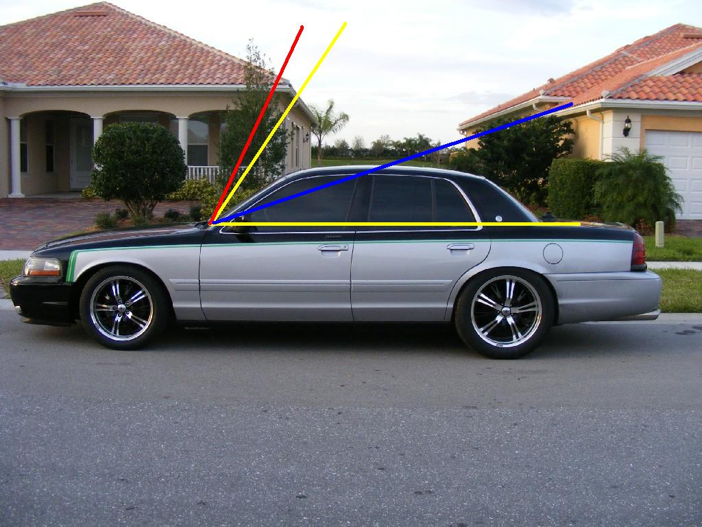

Here are the Sirius and XM elevations for various points in the US.

In this picture, for the antenna on the passenger dash:
Sirius in Miami would be close to good and may only experience occasional outages (yellow).
Sirius in Detroit would have an even easier time of it. (red)
XM in Seattle would SUCK! (blue)
This is a SUPER OVER-SIMPLIFIED drawing for the sake of discussion so keep your flames to yourself!!!
We could get into the true azimuth angle vs the Zenith of the antenna... blah blah. Keep it simple..
OOH. That gives me an idea. When we place the antenna on the passenger dash, the wire trails to the right. if we trailed the wire forward or toward the rear of the car would it make any difference. I'd think not since I'd have confidence in Pioneer putting out an antenna with a fairly round Zenith. It's worth a try, though. Ryan?

Yesssir, I shall do this. It does make sense and I have thought of this in the past, but never executed the plan. Like I have stated before, I have ample wire to relocate. Hey, maybe I could cut a 2" x 3" hole in the roof and mount the antenna there. I could put a piece of glass on to cover it, it would be the worlds smallest sunroof, and allow better transmittal of signals. I'll be right back, I need to get my sawzall...............

Speaking of roof - what would it take to mount the antennae on the roof? Can the wire be routed out the bottom of the antenna, so that only a small wire size hole would do?
Another option? - can two antennae be used, with one on the dash and one near the thrid brake light, such that when one is blocked the other isn't? I'm not sure, but I suspect the XM or Sirius won't mind two antenna, but the GPS might not like two unless the radio is set up to recognize two antennae.
Chip
Only one antenna. You can route the antenna wire under the windshield mldg and put the antenna on the roof. We put most of them there.
