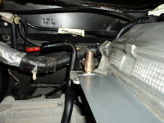

    What changes are made to the tube under the lower intake that requires new hardware?
    I think I reused the oem bolts to remount the tube, might've used one of them, but not needed the other. Also, if you have a rear head cooling mod done, you might have to do this to the tube to clear the fittings:
