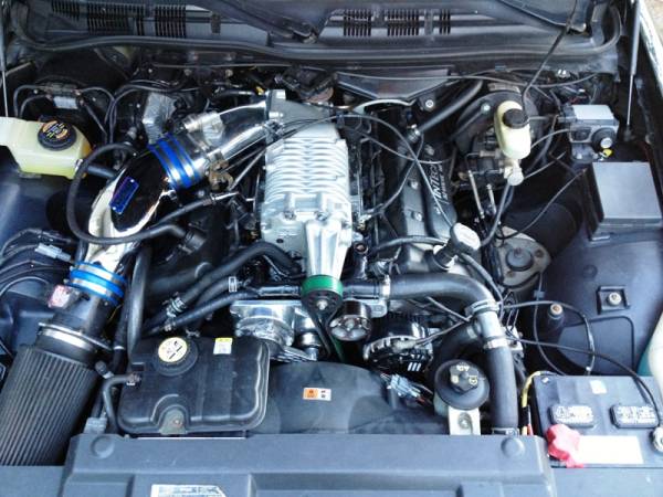

    For anyone that gets the full, high HP Eaton bracket from Jerry, there is an additional pulley on the back of the bracket that the accessory belt runs up and over. The belt I used is: 6PK2540 or a 6rib 100.75" belt.
    P.S. If anyone ever runs a 6lb Lower and 3.0/2.93 Upper with this:
    K080550HD Green Stripe works great

    anyone using the 4" cobra maf adapter from LFP? If so, what filter would I need. I bought the kn re-0870 and the flange wouldn't fit around ring

    Best bang for the buck I've found is the 4" one at Advance auto. Spectre brand.

    Anyone using the cobra lower pulley hub?(metco) Having alignment issues with the blower pulley, it doesn't sit flush against the crank pulley.

    Guys I can't understand what pulley I need for the eaton swap ?
    Is the stock idler smooth pulley OK ?
    Do I need to change the alternator pulley to ribbed one or install it backward ?
    Is the stock Belt tensioner OK ? or need the ribbed one too ?
    I'm really confused about the pulleys I already got the upper and the lower pulley.

    All that info is in the very first post.
