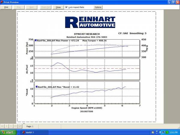

    Well I got the GT on the dyno today and I will say I am very happy with the results, the car made exactly what I wanted for boost just under 11 PSI, and with only 17 deg timing the car made 448 RWHP, on completely stock motor and exhaust and was actually adding timing at 6K, so there is far much there but I will keep the car under 460 RWHP on pump gas.This was my First KB 2.8 Mammoth I am very impressed with the kit. I will smooth out the AF and have the dyno and final numbers, tomorrow along with video.

    With 3 degrees more timing and minor A/F corection the car is now making. 472 RWHP and 402RWT and it is still trying to add timing, he is happy and that is my only concern besides safety. I am smoothing out the AF now. I added three percent to the very end.
