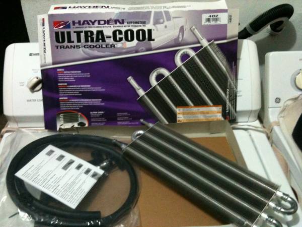

    Here is the cooler with kit I buy to modify, I was expected were more bigger but the other models was smaller than this. next part I have in schedule to buy is the extended capacity transmission pan with drain, I speak with Dennis reinhart and he give a good price, other parts to get is the tranny filter and a few qts of Mercon V, I found a Ford house parts were they sale the Motrocraft MerconV, I check the color and smell of the existing oil and the color is not brown and don't smell to burned, either way I only will replace 4 qts plus two when I installed the new pan will be 6 qts.
